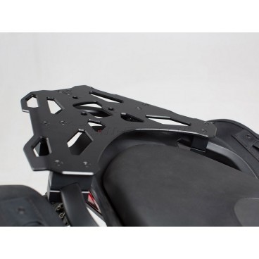

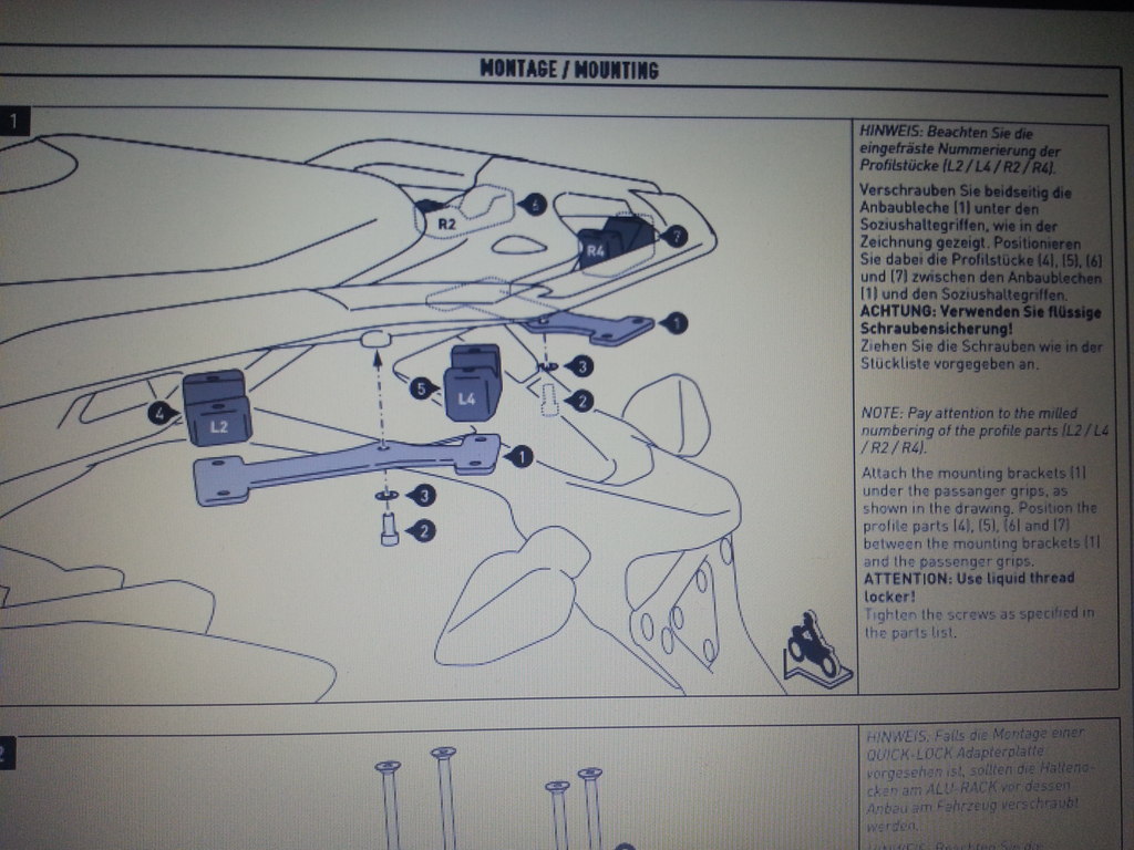

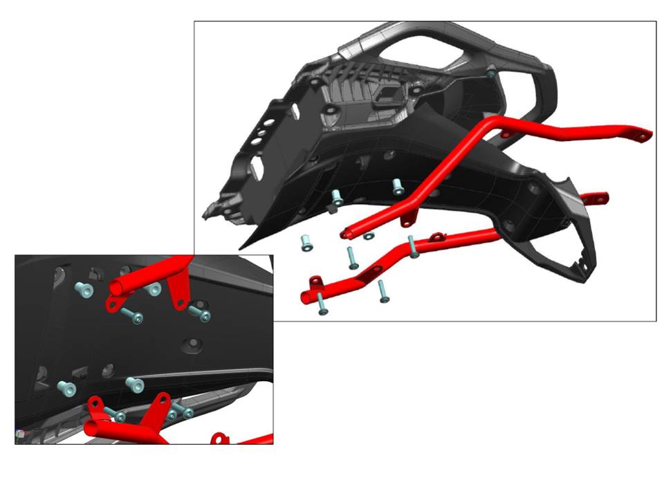

in a last ditch attempt to find an alternative to Ducatis GIVI topbox mount offering (not available on its own!), I found this:- SW-Motech Alu luggage Rack Ducati 1200 Multistrada DVT 2015 | eBay More here (cheaper?) ']Stable luggage carrier - Ducati Multistrada 1200, ALU-RACK by SW-MOTECH. ']PDF fitting kit. I kinda like it, means I can choose a top box I want! ']http://shop.sw-motech.com/cosmoshop/artikelpdf/gpt_22_584_15000_b.pdf[/URL] banditfister2's Story | Photobucket [/URL][/URL]

thanks Johnsosn - Here in the UK I've been told by two different Ducati dealers (Duc Glasgow & J&L Carlisle) that the ducati (GIVI) rack for the Multistrada DVT 2015 model can only be bought WITH the top box. I will check again and thanks for posting this. I was about to hit the buy button on the Urban Packwith a view to sell on the rather plain Duc badged top box .

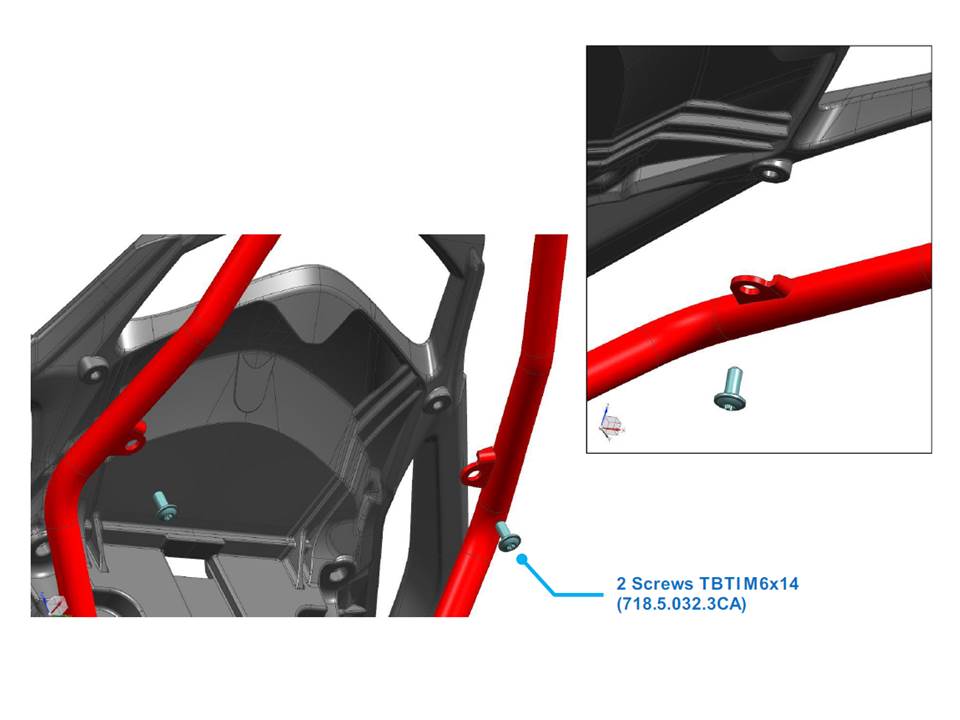

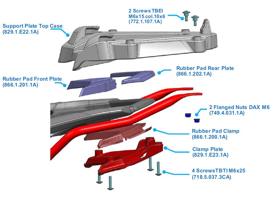

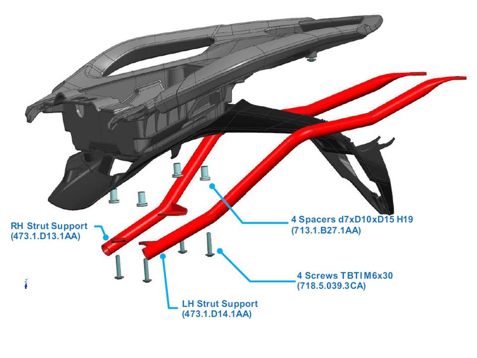

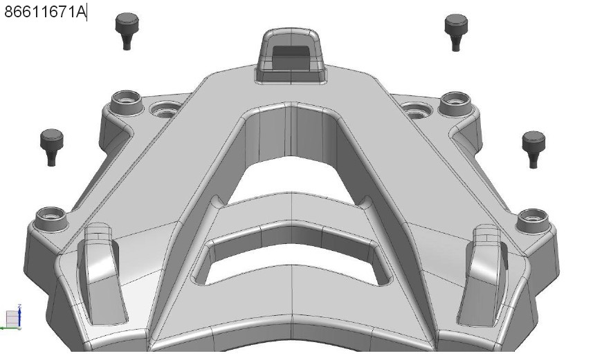

Hello Bandit, As Johnsosn said, I bought the genuine DUCATI plate kit for top box (without top box) in my Spanish dealer too. I had to request all the parts separately, reference by reference, but no problem. Find attached some pics with the entire parts kit that you need with the DUCATI references. Best Regards

Twinme thanks - however the rear rack that Chusky posted (above your post) is specific to the 2015 DVT multistrada. The DVT rear grab rail only has fixing points underneath it not on toplike earlier multistrada models.
Just to add more info, here's Tobers Sw motech DVT MTS rack thread 1200 DVT - Sw-motech Rear Rack Fitted - Pics | Ducati Forum Thanks for posting Tobers
